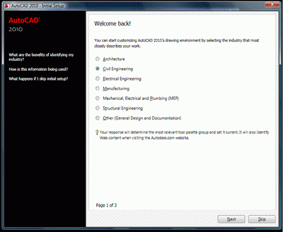

There will be a series of three screens; each one requires that you establish different parameters for your new Workspace. The first screen will ask you for your preferred design industry. Doing this will set your default tool palette to your chosen industry, as well as help Autodesk choose specific web content for you industry.
Figure 2: Pick your industry.

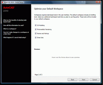

The second screen gives you choices of a few task-based toolsets that you can either include or exclude from your workspace. There are four of them: 3D Modeling, Photorealistic rendering, Review and Markup, and Sheet Sets. Otherwise, your workspace tools will be based on the 2D drafting tools.
Figure 3: The second screen in Setup Wizard allows you to pick from a short list of task-based tools to add to your workspace.

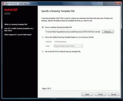

The third and final screen will ask you for a template file. If you already have one that you want to use, then browse to it. You have two other choices of template file sources. You can use AutoCAD software’s default template file, but how boring would that be? The other choice is from a brand-new, industry-specific template file that comes with AutoCAD 2010. Remember on the first screen in the wizard when you chose a design industry? Well, AutoCAD applied that choice here to the new template settings. It will automatically insert your choice here. The other choice you need to make is your units. There are two options, metric and imperial.
Figure 4: The fourth screen allows you choose a template file to use as your default.

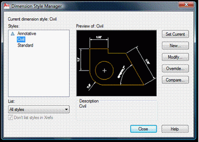

If you chose the industry-specific template, you will find that there are several styles preset in there. For example, when you open the Dimension Style Manager, you will see three default Dimension Styles already created for you. One of them is the classic Standard Dimension style. A second style is an Annotative style, while a third style will be named per the design industry you chose.
In my example I chose Civil as my design industry so I have a Civil Dimension Style. You will find the same naming style in your Multileader Style Manager. The text style manager has four styles, none of which are industry specific. The styles consist of the typical standard text style, an annotative style, and two new ones: notes and titles. The notes style is set to a height typically use for most notes in a drawing where as the title style is about twice as high. This style would be for headings, section call outs, and so on. Of course, you can always make your own, just as before.
Figure 5: The new industry-specific templates have preset styles that are designed for your industry.
