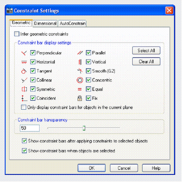

Figure 1: The Constraint Settings manager.  Select which constraints will be applied via Auto Constrain.  It also gives you a list of what constraints are available.

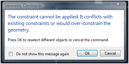

Applying constraints one at a time can be very time consuming.  It can also mean that you miss a constraint that you needed.  One way to speed up the process is to use the Auto Constrain command.   Select this button on the ribbon, then pick the lines that make up the square.  The polygon is instantly constrained.  It should even be fully constrained.  A fully constrained set of objects cannot be constrained any further.  AutoCAD will not permit you to over-constrain your linework. It must always have at least one aspect that is not constrained.  If you over constrain your linework, an error message will appear and you will need to redo your constraining attempts.
Figure 2:  It is not possible to create conflicting constraints.  AutoCAD will warn you with this message and allow you to try again.
Auto constraints are applied in a predetermined order.  By default, Coincident constraints are applied first.  A coincident is where two objects meet.  If you would rather the Equal constraint be applied first, then open the AutoConstrain manager and move the Equal constraint to the top.  AutoCAD will then look for objects that are equal first and apply this constraint.  It then moves on down the list until all pertinent constraint options have been applied.
Figure 3: Auto Constrain will apply geometric constraints to the selected linework in a predefined order.

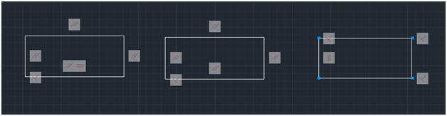

Another method of applying Geometric constraints is through Inferred constraints.  This is similar to Auto constraints, excep that they are not applied en masse through a selection set, but instead are applied as you create objects.  They also apply constraints differently than the Auto Constrain feature.  For example; use the rectangle command to draw a rectangle of any size.  Use the Auto Constrain command.  Turn on Inferred Constraints by clicking on the Infer Constraints icon in the status bar on the far left.  It can also be turned on by selecting the check box in the Constraint Settings manager in the Geometric tab.  Use the Rectangle command again.  Notice that the constraints are similar, but slightly different.  Now use the line command with Ortho on (press F8 to toggle Ortho on/off) to create a rectangle.  The geometric constraints that are applied by inferred constraints is very different this time.  Inferred constraints apply constraints as you draw.  That means it is much more likely to apply a coincident constraint when one or more line segments are created.
Figure 4: The rectangle on the left was constrained with Auto Constraints.  The center with Inferred Constraints.  The shape on the right was drawn with the line command with Inferred Constraints turned on.
