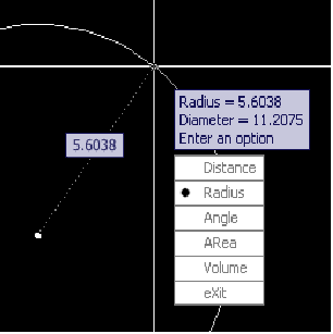

Radius
The radius option in Measuregeom will provide you the radius and diameter of an arc or circle. Pick the Radius option, then select your arc or circle. The radius along with the diameter of the object will be displayed.
Figure 3: The radius option of Measuregeom provides the radius and diameter of a circle or arc.

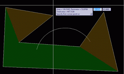

Area
There are two main ways to determine the area of an object or objects. The easiest is the object method. Start the Measuregeom command, select the Area option, then type O for Object. Now select the object. It can be any shape as long as it is a closed object, like a circle, polygon, or region. Measuregeom will display the area and the perimeter of the object. This isn't new or all that special a feature because if the Properties Pallet is open and an object is selected, the same information will be displayed.
Instead of picking an object, pick points to define a shape to find its area. Just start picking points and press enter when finished. Measuregeom will display the area of the shape you defined. However, with Measuregeom, you can add or subtract from the total area. Before you start picking your points, type A for ADD. Now pick your points for the total area. Type S for subtract and pick points in your original shape to subtract this shape’s area from the first. If you look at figure 4, you will see a shape that has been selected. This is the green area. The brown areas have been subtracted and a new total area (and perimeter) are given.
Figure 4: Measuregeom's Area option has given us the total area (and perimeter) of this shape. The areas shaded brown have been removed from the shape’s measurement. The new area is displayed. (Click on image to enlarge.)
