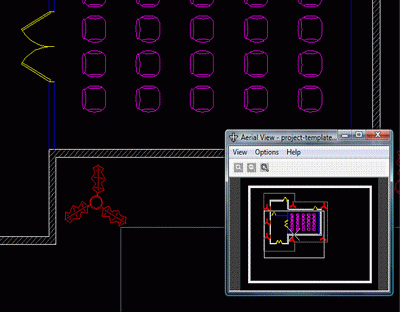

Aerial viewer
This command can be very useful to help you navigate around a large drawing. Type dsviewer on the command line to start it. It opens up a new window that displays the entire drawing for you to see. In this window is a smaller window that indicates your current view. Move that window to pan the drawing. Zoom in and out in the viewer to, well, zoom in and out of the drawing view. You can use the Aerial View window to quickly change the view of your current viewport. It even allows you to pan/zoom without interrupting your current command. It's another tool that can help you work more quickly, especially in large files.
Figure 2 (click to enlarge): The Aerial View window is used to navigate a drawing file very quickly and in a way that won't interrupt your current command.

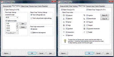

Hopefully you are using object snaps to create accurate linework. If not, then how are you getting your lines and arcs in the right place? There are many options available to you when using Osnaps. Running Osnaps are great. This setting keeps your Osnaps on all of the time. You can select which osanps to run with. You can also turn on Polar Tracking and Object Snap tracking. Polar Tracking is a sort of Ortho option that allows you to “snap” your cursor to a specific angle. You can use the default angles or add the ones you want to use. This is a great tool if you want to draw an isometric view of your design. Object Snap tracking allows you to “snap” to virtual osnap points. It can extend lines to virtual intersection points that aren’t normally available. It can force your cursor to draw perpendicular from and objects midpoint! To get to these settings and all of your osnap settings, type OS on the command line.
Figure 3: Left - The Polar Tracking Tab of the drafting settings window. Set the angles you want to snap to. Right - The Osnap Settings tab. Pick which osnaps you want to have running, and turn on/off Object Snap Tracking.
