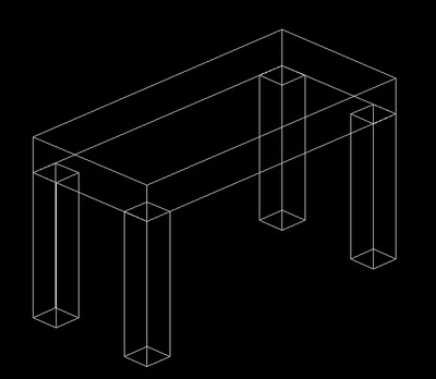

These are very similar to the standard primitives to which we are already accustomed. If you wanted to create a basic table consisting of a top and four legs, you can use primitives. The "old" or standard primitives can very quickly create a table as shown in Figure 2. I used the box primitive to create the top and legs.
Figure 2: A simple table created with standard primitives.

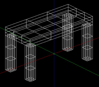

If we used Mesh Primitives, (the mesh box primitive), we would get what is shown in Figure 3.
Figure 3: A table similar to that in Figure 2, but created with mesh box primitives.
Right away you can see the main difference between the solid objects in Figure 2 and the objects in Figure 3. The Figure 3 objects have more tessellation - or more vertices and edges. When you create a mesh primitive, you can set the range of tessellation beforehand. When you convert an object to a mesh, you can tell it how much tessellation it can have. Vertices, intersection points, and faces are editable. You can use the gizmos we discussed in the May 2009 issue of AUGI HotNews to alter the objects.

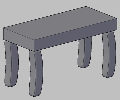

Figure 5: This is the same table as in Figure 3 except that the legs have been smoothed and "warped" using the new gizmos.

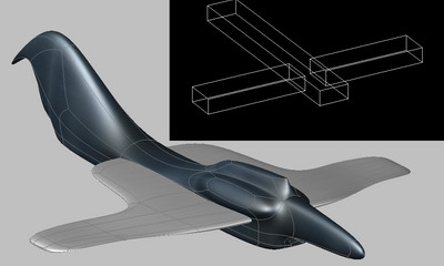

Figure 6: I started with three primitive boxes (top right) and quickly used the tools discussed to create this plane.
