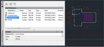

AutoCAD 2011 makes their selection even easier. When a reference object is selected in a drawing (Xrefs, images, DWFs, PDFs, etc.) the corresponding reference is selected in the External Reference palette. The opposite is also true. When you select a reference in the palette, the reference is highlighted in the drawing. This helps you to find the files that you are picking. Keep in mind that this only highlights the reference files - it doesn't select them for you. If this behavior annoys you, you can turn off the feature through the system variable ERHIGHLIGHT. A setting of zero turns it off; a setting of one turns it on.
Figure 1: Click to enlarge The Reference Manager now supports object highlighting when a reference file is selected.

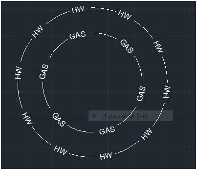

Have you ever used a linetype that has text in it? If not, why not? If you have then you know that many times that text can be upside down. The orientation of the text depends on which end point of the line was drawn first. AutoCAD 2011 line types now have three possible orientation settings available: U for upright, R for relative, and A for absolute.
Figure 2: The new text alignment feature keeps text in custom linetypes orientated properly.
