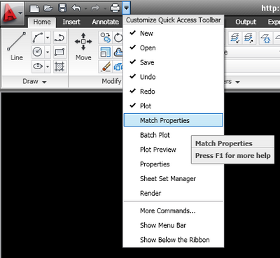

Autodesk gave us the QAT in 2009, but it was a little difficult to customize. You had to jump through several hoops in the CUI to do anything with it. In order to customize it in AutoCAD 2010, click the down arrow on the right side of the QAT and click the commands you want in it. If you don't want them in there anymore, do the same, but turn them off. And if you right-click any of the commands in the QAT, you get customization options. If there is a command you don't see in the list, click the MORE COMMANDS button to open the CUI window, find the command, and drag it into the QAT. Very easy.
Figure 1: Click the arrow to open the QAT customization tools.

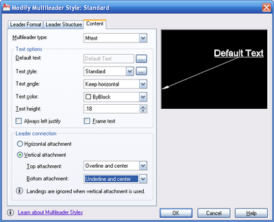

Editing multileaders has gotten easier. Now you can grip edit the text just like mutlitext. If you want to expand or stretch the text box, grip edit it. The styles manager has been updated to provide more control of the leader connections. In the Leader Structure Tab, you can specify vertical attachment, not just horizontal. On the content tab, you can specify a scale when a block multileader type is selected. The block scale is now displayed in the properties manager. A new button on the content tab gives you direct access to the Text Style dialog box. That means that you can create or modify a text style without leaving the multileader style dialog box. One last thing, if you use the MLEADEREDIT command to add or subtract leaders from your multileader, you no longer have to select an option to either add or subtract leaders. It now adds leaders by default until you tell it to subtract.
Figure 2: Multileader settings can now control the vertical attachment of the text to the leader.

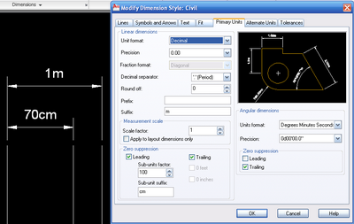

The Primary and Alternate Units Tabs have a new Sub-Units feature, which provides new controls for leading zero suppression. It only works for metric units, but essentially you can set the dimensions to automatically switch to centimeters if the dimension measures less than a meter, or however you set it. For example, if the units are set to meter and you set the sub-units to 100 (and make the sub-unit suffix cm) then when the dimension measures below 1 unit (like .86 units) it will multiply the measured unit by the subunit and display the sub-unit suffix.
Figure 3: The new Sub-Units factor is used here to display a dimension of 0.7 meters as 70 centimeters.

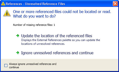

If you open a file that has unresolved references, a new warning pops up. You will be given two options: either ignore the warning or click to update the file location. Selecting this option will open the External References Palette so you can repath the missing file. There is a box at the bottom of the warning window where you can click to always ignore this warning.
Figure 4: Here is the warning window when a file with unresolved reference files is opened.

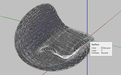

We aren't quite finished yet. There is one major aspect to AutoCAD 2010 that we haven't discussed. Those features are in AutoCAD’s new 3D features and free-form design abilities. AutoCAD 2010 can handle meshes now and has improved 3D operations. The free-form design features can create meshes, creases, and smooth 3d solids, allowing for more organic models to be created. Yes, organic modeling has finally come to AutoCAD!
Figure 5: This free-form model, made of two rectangle box objects, was turned into a mesh surface with AutoCAD 2010 software’s new free form modeling tools.
