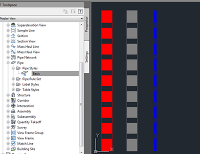

You can have one style for all of your different pipe networks and, if you use one visual representation for all of these objects and the different layers control their appearance (for Civil 3D this would be their object layer), then one style may be all you need. It is more likely that you'll need more than one, but you should only need a couple using the Quick Start method. Some objects such as points are still likely to have several more styles; it will depend on how you use your software and work with your points.

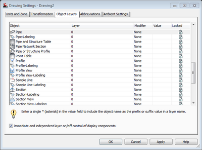

In order for you to get your style to use the object layer, you have to adjust your style to use byblock for the object's display layers. Then if you have Civil 3D use the desired layer for the object layer, and for other pipes you can select them after they are created and place them on any layer of your choice, then the pipes will use that layers properties for their display. You can also have all of your object layers set to use layer 0. You simply have to select them and place them on the desired layer after you create them, or at some time during the drawing or design process. This method is more like the way many users operate in Land Desktop, Land Development Desktop, Softddesk, and AutoCAD, which are the products many C3D users were using prior to their move to the Civil 3D platform. If there was an option in the object layers to use the current layer, this would be how many AutoCAD users are accustomed to designing. Currently, there is not and I do not expect that Autodesk will add this option since this is not how Civil 3D was designed to be used. We are cheating, if you will.

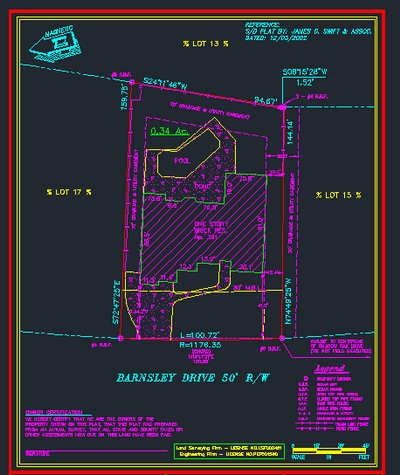

Of course, there are limits to using this method to operate in Civil 3D, but for existing condition drawings this can be another option and a quicker transition from another software platform to Civil 3D. For larger firms, this could be an option as well, maybe as a multi-stage approach to implementing Civil 3D. These firms could begin with the Quick Start method and then after users are more comfortable with this BIM platform, they could implement standard Civil 3D and a stronger style-based workflow.
