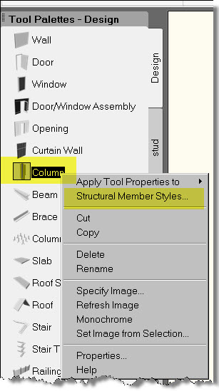

  • In the tool palette under the Design tab, right-click on the Column, Beam, or the Brace tool and select Structural member Styles...

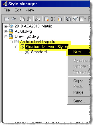

    You will see the Style Manager dialog opening up.
  • In the left pane, under Architectural Objects, right-click on Structural member Styles, and select new.
  • Type a name for the structural member style. Keep the name meaningful. I used the name Hollow_600X600. You can make it as descriptive as you want, depending upon the style you create.

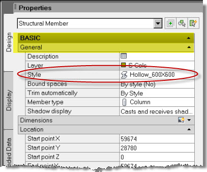

  • Select the column you just placed.
  • In the Properties palette, make sure the Design tab is selected. If the Properties palette is not visible, use Ctrl+1.
  • Under Basic, and under General, change the style to Hollow 600x600.

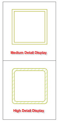

  • Make sure that Medium Detail display configuration is selected (at the drawing status bar).
  • Now change the display configuration to High Detail and see how the column graphics change to reveal more details.
Observe the way the High Detail configuration uses the shape you defined (with filleted corners) to be used for High Detail using the Membershape command. Once you learn the concepts of display configuration, you can customize the way the column is represented in a high or low detail configuration.
