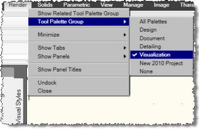

When you right click on the Tab Title area or any empty space in the ribbon other than panels
You will get a menu with more options. Refer to the figure below.
Tool Palette Group: You can associate a Tool Palette Group with each tab. For example, the Render tab can be associated with the Visualization Tool Palette Group. For some of the tabs, you can set this to "None."
Once done, clicking the Show Related Tool Palette Group option will make the associated Tool Palette Group current. But before doing this, you need to make the tab active by clicking it. Referring to the image above, if you make the "render" tab active and then right-click and select the Show Related Tool Palette Group option, you can see that the Visualization Tool Palette is set current for you.
